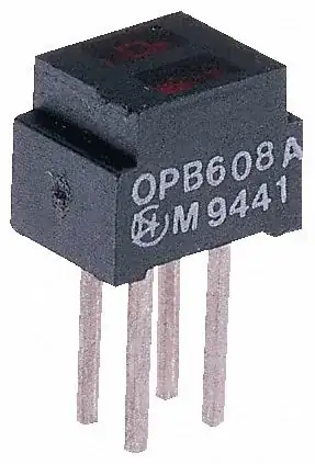

A lot (if not most) LEDs have some kind of small thickenings on their legs. Sometimes they are almost as wide as the leg itself and barely visible, sometimes they are twice as wide and instantly noticeable.
When present they seem to be the same on all legs, so I doubt they are used to indicate anode or cathode. The only explanations that come to mind are:
  1. They are a manufacturing by-product, possibly a place for holding LEDs during manufacture.
  2. They are designed to provide a bigger soldering surface.
Here's an image that shows them on both legs (sized 1 x 0.6mm):
They might not be specific to LEDs alone, but are commonly seen on them.

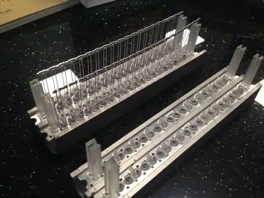

From here this is what the leadframe looks like.
This is what they look like when they are molded in small scale production:
After this, the parts are separated but the die is made so that it does not weaken the lead, which means it has to be a bit wider in that area. So the remaining nubs are artifacts of the production process, like ejector pin marks on a molding.
