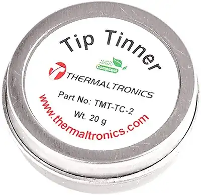

imho, there is no substitute for using tip tinner. You can find it easily on eBay or Amazon, and probably other places.
Just heat up the iron and push it into the stuff for a second, then wipe it off on a damp sponge.
