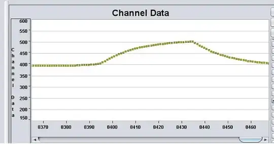

We use the CapTIvateDesignCenter to monitor the measurement result. Here is what we get:
First with a dry touch:
And then with a water drop:
The idle state of the signal lies at the +400 level. As you can see, the effect of water drop is weaker than the effect of a dry touch, but still goes in the same direction (an increase of the measurement signal, meaning a decrease of the mutual-capacitance).
