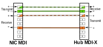

Edit 3: It has been suggested that this is an MDI-MDIX problem. If I'm connecting a straight-through (not cross-over) ethernet cable from my computer to the device (which works on the test board), the device should behave as the Hub MDI-X device in this image:
MDI - MDI-X
I had connected pin 1 to TD+ but perhaps I should be connecting pin 1 to RD+, etc.
Edit 4: It turns out the four leads do have to be reversed, which is equivalent to using a cross-over cable. So RD+ goes to TD+, and RD- to TD-, etc. Then, everything works as expected.

  • Could it be a simple MDI/MDIX problem? – fraxinus Aug 25 '20 at 11:36
  • @fraxinus Yeah, it could. I touched on that in my question before I knew the terminology. If you see this, would you mind confirming/rejecting my final observation in edit 3? Of course I'll simply test it when I have time. – Rob Skelly Aug 25 '20 at 18:39
    @RobSkelly I would try both ways. Most modern NICs and switches can sense MDI/MDIX connection, but may as well fail to sense anything or sense something wrong. – fraxinus Aug 25 '20 at 18:58
