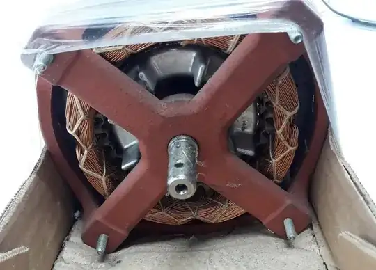

I got an induction motor in a junkyard, a WEG motor made for an Electrolux washing machine.
It is a single-phase 1/2 hp 4 pole motor. It runs in 127 V and has a 40 uf capacitor feeding the auxiliary winding.
Here's a photo of an identical one I found on the internet (mine is currently disassembled):
A motor identical to  mine

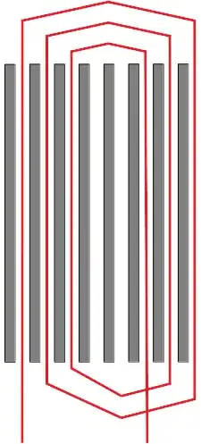

After several tests I could assure it was what It looked from visual inspection, a concentric winding scheme where each unit looks like this:
concentric winding unit
