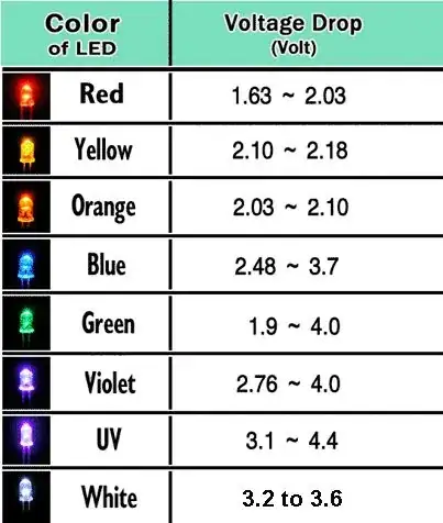

LEDs require a minimum forward voltage (Vf) to operate. Red requires about 2V,
This table is 'somewhat generalised' but gives an idea.
Modern white LEDs typically need 3V or more. If you have control electronics then you also need some "headroom voltage". If you are operating white LEDs directly from battery then 3 x NimH will work acceptably and 4 is probably better.
