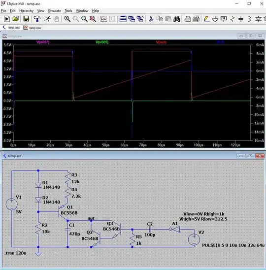

Here is my nearly perfect simple solution. I just need to build it tomorrow.
Spehro Pefhany's PNP correction of course set the stage. However the discharging circuit would be a practical problem driving it from the little poor man's edge detector. But wit the Darlington pair I am doing better than with some exotic N-MOSFET.
R4 will of course be a 10k potentiometer to adjust.
Replacing R1 with the two diodes is supposed to make it more stable.
UPDATE: There is a difference between theory and practice. In practice the little pulse generated by the 100pF / 1k high pass filter was not enough to set the Darlington pair off. I could run it through a buffer (like an amplifier to bring it to logic level) or two inverters, and then it would work. But that's wasting two 3 inverter stages total. I tried to use a negative edge detection and one inverter to make a full upward pulse, but the negative spike doesn't go low enough to trigger the inverter.
For now I am back at just using the RCO as a reset pulse. And when I do that I don't need a Darlington pair either. I am wasting one pixel doing that. Not ideal but fair enough for the time being.
