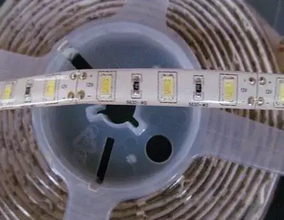

Recently I bought some "300LED/5meter Waterproof 5630 SMD LED Flexable Strip" i.e. High brightness LED strips from China. In the specifications, it was said that the strip consumes 75W @ 12v, which equates to 6.25A @ 12v.
I first tested the LED strips with a 12v 2.5a power supply, seeing as it was the easiest to find. Later I found my 12v 5a power supply, and I was surprised to see very little difference between the two power supplies (in terms of perceptible brightness). Not having any proper test equipment on hand, I bought it over to my local hackerspace which is a little more suited towards doing things like this.

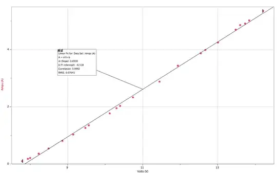

After setting up the LED strip so that it's connected to a 3~20v <10a bench power supply, a voltmeter and an ammeter, I took a video of the readouts from the two meters, whilst I increased the voltage: http://youtu.be/uX-3r6mrF9A
The results I obtained were... interesting :P Graph comparing voltage against amps. Surprisingly, at 12v, I only got 3.44a (41.28w, 45% less than advertised value!). You can get the results here (google doc).

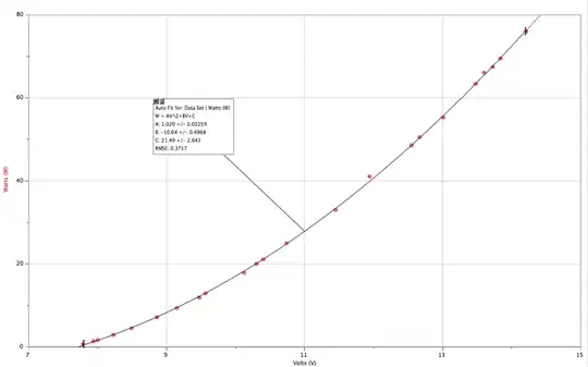

I then plotted watts against volts, and it turns out that I would need to power this strip at 14.14v in order to get 75w! Graph comparing watts against voltage
Basically, I'm not overly happy with the performance of this LED strip. In order to get the correct power output, you would have to overvolt it by 2.14v, which has the potential to significantly reduce the LED's lifetime. Unfortunately, I was unable to measure the exact voltage at the individual LED level (they were epoxied), but I suspect that they would need at least some heat-sinking if they're to operate for any period of time.

The 'specs' (pasted below) indicate 12V, not 12.0V. I'd guess that this product is made to be compatible with automotive 12V, which is usually in the 13.8 to 14.2V range. Your measurements somewhat confirm this.

Sasha, most Chinese LED strip manufacturers use very thin copper film in strip's FCB (Flexible Printed Board). They rate LED strip "theoretical" power without taking in to consideration copper resistance. When 12v applied to the LED strip wire leads, the voltage at the opposite end of the strip will be substantially lower because of the resistance loss in FCB copper. In order to get full 72 watt from those strips, run pair of 12 gauge wires parallel to that strip and connect those wires to every FCB stitch pint located 50cm apart.
