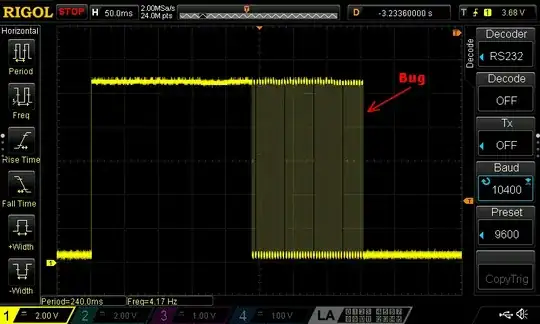

And one of the ugliest bugs is the knob "Horizontal Position". This is complete crap. It should move the signal horizontally on the screen. But it works so bad that moving the knob fast results in the signal suddenly jumping to a completely different loaction. When you move it slowly it nearly does not move at all. Such a basic functionality as navigating in a long capture with a Rigol oscilloscope is a pain!
And when you move that knob too fast you get suddenly artifacts in the signal. The same signal which I caputured above, suddenly looks like this:
Rogol DS1074 bug artifacts
Amplifying this bug you see a square signal of 2 ms period. This signal has never existed on the input of the oscilloscope. It is produced by a software bug in the oscilloscope just by moving the captured signal in memory horizontally on the screen!! Here you see a zoom of the left artifact:
Rigol bug 2ms square wave signal
And this is a zoom of the right artifact:
Rigol bug artifact

My MSO1104Z system info page also shows it is running version 00.04.04.SP4, but according to my records the last firmware I loaded was 00.04.04.04.02. So I downloaded and installed 00.04.04.04.03 from the Rigol website. Now the system info page helpfully still shows 00.04.04.SP4, and as expected the timing problem still exists with 4MSa/s acquisition.
Same info shown for both firmware releases
I've return the acquisition memory depth setting to auto on my scope to hopefully avoid seeing this again when I use the scope and forget that I changed it to 24Mpts.
Edit to add: I attempted to reproduce with the logic analyser inputs, but I couldn't get a 4MSa/s data rate with those enabled. I couldn't reproduce with any of the other acquisition settings I tried either.
Kean
  • Do you get 800us for the test signal when acquired at 24M with 5 seconds timebase? – Sredni Vashtar Aug 27 '20 at 18:59
    I get total garbage for the period measurement at 5s/div. Depending on zoom I get various readings like 10us, 20us, 400us, 800us, and 1ms. – Kean Aug 28 '20 at 00:26
