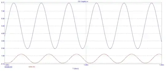

Maybe it's best to use a simulator to show where the gain becomes limited. Here's the “basic” circuit I used and note, that in the first instant, I didn't connect the emitter capacitor C4: -
Note the waveforms; blue is Vout and red is Ve (emitter): -
They "collide" at about 3.1 volts and this prevents any serious increase in output amplitude. In other words, the “basic” common-emitter Colpitts oscillator will always tend to have a significant sinewave distortion.

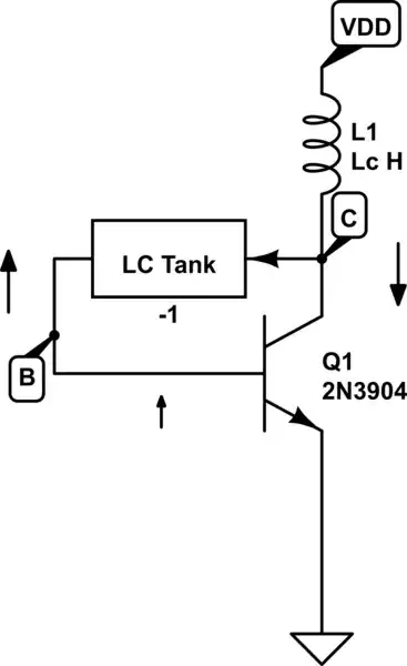

Before answering your question, let me explain briefly how this Colpitts topology works. Then, I will answer your main question.

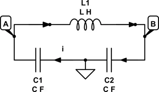

Working of the Colpitts Oscillator
Consider an LC tank with node between the capacitors grounded as shown below:
You might know from basic electronics that if the capacitors have some initial charge, then the LC tank will start oscillating. Let \$v_A\$ be the voltage at node A and \$i\$ be the current through the capacitors then, voltage at node B, \$v_B\$, will be: $$v_B = i.\frac{1}{sC} = -v_A$$ Thus, the LC tank will have opposite voltages at its two ends A and B. In other words, between A and B LC tank has a transfer function \$-1\$. Due to the losses inside the tank the oscillations would eventually die out unless there is some positive feedback.
Now consider putting this tank across an inverting amplifier as shown below:
simulate this circuit
Since there are two inversions in the loop as shown by the arrows, a positive feedback is created which compensates for the tank losses and results in sustained oscillations.
Oscillation Start-up
For oscillation amplitude to build up, it needs to be ensured that the positive feedback has sufficient loop gain. Let's calculate it.
You might know that a real LC tank is modelled as a parallel combination of L, C and resistor R which models the tank losses. At resonance, the LC part has infinite impedance so the tank can be represented by just its resistance R. In this situation we have a circuit as shown:
Here I have broken the loop at node B to calculate the Loop gain. It can be easily calculated to be: $$L = g_mR$$ For oscillation buildup, \$L\gt 1\$, thus \$g_m \gt \frac{1}{R}\$.

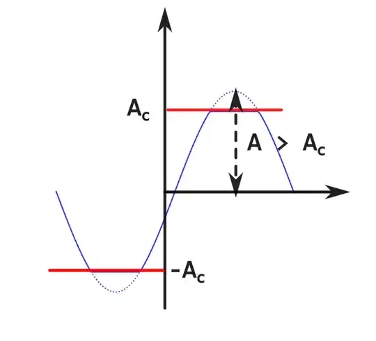

Amplitude feedback during Steady State Oscillation
Suppose we have a system with clipping non-linearity as shown:
Suppose we give it a sinusoidal input with amplitude A and frequency f. As long as, the gain is less than the range of the clipping non-linearity (NL), the input comes out undistorted. For gain greater than the range of the NL, output will be clipped and the amplitude of the fundamental component will be given by: $$A_o = \frac{4A_c}{\pi}$$ The gain of the system at this frequency becomes: $$G = \frac{A_o}{A} = \frac{4A_c}{\pi A}$$
Thus the gain of the system falls at higher amplitudes.
The transconductance of transistor actually behave quite similar to such non-linear system. Due to supply or current limitations and device non-linearity, the \$g_m\$ does not stay constant for all amplitudes instead starts to fall for larger amplitudes. For instance, in your case, the maximum current corresponds to \$I_{max} = \frac{V_{DD} - V_{CEsat}}{\omega L}\$. Above this current, the transistor ceases to be in active region. The \$g_m\$ can be plotted against amplitude and is shown below: enter image description here
It is easy to see the amplitude feedback now.
For amplitude smaller than \$A_{osc}\$, \$g_m \gt \frac{1}{R}\$ resulting in high loop gain and increasing amplitude.
Similarly, for amplitude smaller than \$A_{osc}\$, \$g_m \lt \frac{1}{R}\$ resulting in low loop gain and decreasing amplitude.
Due to this feedback created by the non-linearity of the circuit, the amplitude remains stable at \$A_{osc}\$, where loop gain is 1.
Hope it answers your question.
