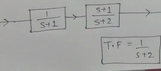

I'm thinking about a mathematical possibility how an open loop system can replace a close loop system so here is my explanation
Let's say I have a plant with transfer function as given in image (1)enter image description here
But to achieve a desired output with minimum effect of disturbances ,I Make it a close loop with unity feedback and it works very well (image 2)enter image description here
this time I make a Cascade connection with plant such that overall transfer function is same as close loop transfer function (image 3)enter image description here
Since transfer function in this case is equal to previous close loop transfer function so for the same input output should be same in both conditions , so we can say an open loop replaced a close loop system?

    You can't just stick additional transfer functions *after* the plant. "Yes boss, my robot is slamming into a brick wall at full speed, but the digital corrections we apply to the sensor readings say that it's exactly where it's supposed to be!" I suppose you can put your new transfer function before the plant, but that's not what's shown in the picture. – user253751 Aug 18 '20 at 17:05
Too long for a comment.
Think about the physics of the problem. Due to small variations in the components of the plant, the original system may change from \$\frac{1}{s+1}\$ to, say, \$\frac{1}{s+1.2}\$. Then your scheme of cancelling unwanted dynamics won't work.
The situation becomes much much worse when the original system is an unstable system. The original system will get damaged due to its instability while the output of the cascade system hides that fact.
More over, even if the parameters don't change, very very very rarely do we know the exact transfer function of the original system. So this scheme is not suitable for practical applications.
To see why closed loop control is necessary go through the first few chapters of any basic control system text book. They will give more reasons for utilising closed loop control.
Well, you think it works well but it doesn't in reality. If you want a precision control system you need much more gain (and probably integral and maybe some differential) error amplification after the summer (called G below): -
And, if you considered an expanded picture of what a good control loop has to deal with you'd draw this (featuring load effects and "other nasties"): -
  • Thanks Andy! But about my main concern why I cannot replace close loop system by an open loop system of same transfer function , When both system give same outputs for same input? – user215805 Aug 18 '20 at 15:11
  • Because it's unrealistic of a real control system that has to drive against friction, move mass and deal with noise and surges. All of that before we get into plant non-linearity, stiction and dead-band problems. – Andy aka Aug 18 '20 at 15:39
  • Open loop can only control speed or voltage with no loading effects, otherwise load regulation error and no regulation at all except no load inside inside BW unity gain/2 – Tony Stewart EE75 Aug 18 '20 at 15:54
