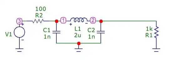

The resonant circuit can be simulated. It needs a load and signal source which is not a directly to C1 connected voltage source, something must be between to make C1 effective. I inserted a resistor in the next example. Transistor amp output is a current source.
In the next example the resonant circuit attenuates the signal source voltage about 1dB at the frequency where the phase shift is 180 degrees - no problem to have an amp which amplifies enough for oscillation at few megahertz.
