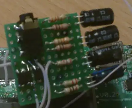

Too many indicators can lead to confusion from the user side :
Too many indicators
Image link
The indicators you have on your board seem to be very numerous and are useful only for a maintenance engineer. I don't know what is the architecture of your boards but probably it is better to use software checks or hardware test loop for the maintenance in case of issues :

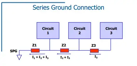

Cons
  • Longer design time: although mostly fairly easy to add a LED, it cost time.
  • Reduced power: you already mentioned it, but probably you mean the (micro)Amperes the LED itself is using is deducted from the total. However, also by using a LED, the current is reduced from the original path (unless e.g. a transistor is used), so it affects the current also of the area 'around' the LED.
  • Added/changed GND return paths: as each LED has a return path, could affect e.g. analog (parts of) PCB boards.
  • CPU pin usage: when using a software controlled LED, it cost a pin, or a multiplexer output.
  • Board space: already mentioned by you, however also take the description text next to each LED into account.
