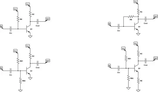

Some Variations of BJT CE Stages
I'd like to start by throwing a bunch of slight variations on a theme. All of these below are similar BJT CE stages with similar purposes and applications. However, someday you'll want to be aware of some of the differences between them. For now, I just want to toss them out so that you won't be surprised by any of them.
simulate this circuit
All of the above are single-ended and AC-coupled. Some exhibit highly variable gain and some don't, some are highly sensitive to ambient temperature and some aren't, some have much higher input impedance and some have much lower input impedance, some provide more degrees of design freedom and some less so. So there are various reasons for these.
I've neglected many of the incarnations that were found when germanium BJTs were more common (they have their own problems.) And I've removed some of the circuit incarnations that include modest isolation from the supply rails or where a real designer actually worked to properly shape the response of the amplifier over frequency. Trying to catalog every possible incarnation would be impossible here, anyway. But once you get a few basic variations on the theme down, they will all look similar to you and you'll immediately recognize "why this, not that" among them for any particular circumstance.
Also, many of the problems of some of the above can be repaired through something called global NFB (global negative feedback.) This is yet another concept you'll need in order to understand systems that include multiple stages chained together, for example. But that's for a later time, I think.
