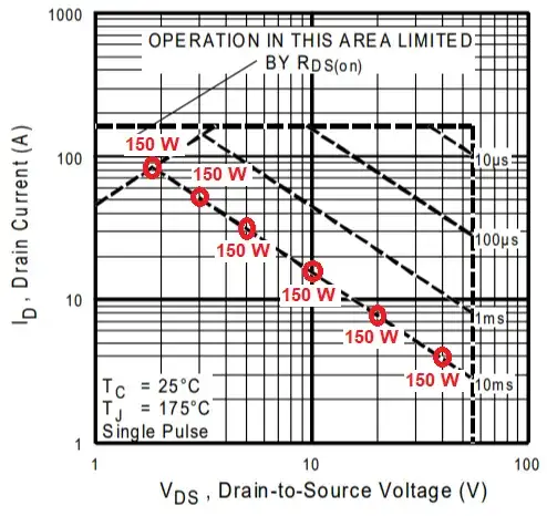

What does indicated time in below graph means?
It's the length of time that the MOSFET can reliably conduct for the applied drain-source voltage and drain current. For instance, with a drain current of 10 amps, the drain-source voltage can be about 15 volts - that's a power dissipation of 150 watts and, that power can be "safely" dissipated for a maximum duration of 10 ms.
Or, if the drain-source voltage is 10 volts, the drain current could be around 15 amps. Again that's a power dissipation maximum of 150 watts: -
What you see is a constant power line of 150 watts and, given that case temperature and junction temperature are stated (25 °C and 175 °C), we see that the thermal impedance is: -
$$\boxed{\text{150 °C / 150 watts or 1 °C / watt}}$$
If the dissipation time period is reduced to 1 ms, then the drain current could be about 45 amps at a drain-source voltage of 10 volts - that's a power dissipation of about 450 watts
So, generally, the shorter the time period, the bigger the power event can be.
But, be very aware that approaching these limits must be done with proper consideration of ambient temperature and heat-sinking requirements as specified in the data sheet.

I've added three points to the above graph at: -
  • 10 ms (1 °C / watt),
  • 1 ms (0.35 °C / watt) and
  • 0.1 ms (0.1 °C / watt).
I've covered the 10 ms thermal impedance further above.
At 1 ms, it's 0.35 °C / watt hence, with a maximum case to junction temperature difference of 150 °C we can expect to cope with a power of 150/0.35 = 429 watts. I estimated 450 watts from the earlier SOA graph and this ties in nicely albeit with some slight error. In other words, it's better to use the thermal impedance graph because it's more relevant especially when it also plots duty cycle - the SOA graph assumes a single pulse and is unrealistic in many practical cases.
At 0.1 ms the thermal impedance is 0.1 °C / watt and, with a case/junction difference of 150 °C, that allows a peak power of 1500 watts. If you look at the SOA graph for 0.1 ms, you can see that it bisects the co-ordinates 50 amps and 30 volts i.e. 1500 watts.
    150W for 10ms with or without heatsink OR a heatsink will increase the amount of time as long as we don't hit the temperature/wattage limit? – ElectronSurf Aug 10 '20 at 08:26
    @ElectronSurf the above graph has a case temperature (\$T_C\$) of 25 °C and has the junction temperature (\$T_J\$) at 175 °C. That defines the transient thermal impedance of the device i.e. (175 - 25) °C per 150 watts or 1 °C/watt. See also figure 11 for the same number. From figure 11 (at 10 ms) we are at the limit where this can be sustained by an infinite heatsink. Remember that the SOA curve is a maximum and should only be approached for shorter durations than those specified. – Andy aka Aug 10 '20 at 08:53
    The little red circles add values to the graph and indeed help newbies like me to appreciate the "three dimension/variable" relationship. I am a 2D human with 2D eyes and always found it hard to read 3D. :) – tlfong01 Aug 10 '20 at 09:11
    Thanks for extending the answer. – ElectronSurf Aug 10 '20 at 10:54
