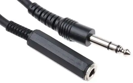

Presumably a straight jack will work so, get a short adapter cable like this one: -
Or this one: -
  • These are speaker extensions, not power ones. He'd need one without the multi-terminal jack since these are set up for L/R audio... – Ron Beyer Aug 07 '20 at 12:57
  • These are just examples - mono ones can be purchased that are suitable for the current and voltage. – Andy aka Aug 07 '20 at 13:00
