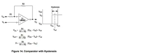

Appendix B - Op-amp Comparator
op amp comparator
LM324 Single Supply Quad Op-amp Datasheet - Fairchild
lm324 comparator
