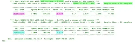

Now I have wired two MCP3201s for troubleshooting and cross/self calibration. I found that the accuracy is < 0.5%, max/min difference for 10 samples < 0.015V.

The OP is using SPI speed 1.35MHz to do the testing. Now I am testing MCP3201 the accuracy of converting a voltage of 1.68V with the voltage reference also 1.68V (Vcc/2) without using any by pass capacitors at MCP3201 Vcc and voltage reference. I tested over a range of 10kHz to 10 MHz. I found that the readings at 1 MHz or over is unreliable. So from now on I will only test at 1Mhz or below.
mcp3201 test 10khz to 10MHz
Now I am testing again, this time only on 100kH, 400kHz, and 1MHz, and over 100 samples. I found there is not much accuracy advantage using lower 100kHz and 400kHz, so from now on I only focus on 1MHz.
mcp3201 test 2

# *** Sample Output ***
>>> %Run adc_util_01_v111.py
     Begin program adcutil_01_v111  tlfong01  2020-08-12 13:40
       # *** Test MCP3201 ADC with Ref Voltage = 1.68V, and a range of SPI speeds ***
         Test Config: SPI Port = SpiPort00 ; ADC = MCP3201 ; Speed List = All speeds name list ; Sample Size = 10 samples
           SPI Port      Speed   Mean Raw  Mean Volt  Error (%)   Max Volt   Min Volt MaxMin Dif
          SpiPort00     10 kHz     0x07ff      1.650        1.8      1.652      1.646      0.006
          SpiPort00     50 kHz     0x0802      1.652        1.7      1.652      1.646      0.006
          SpiPort00    100 kHz     0x07ff      1.650        1.8      1.650      1.647      0.003
          SpiPort00    400 kHz     0x07fe      1.649        1.9      1.651      1.649      0.002
          SpiPort00      1 MHz     0x0803      1.653        1.6      1.655      1.650      0.005
          SpiPort00      2 MHz     0x07cc      1.608        4.3      1.608      1.604      0.005
          SpiPort00      4 MHz     0x06ce      1.404       16.4      1.406      1.404      0.002
          SpiPort00      5 MHz     0x0773      1.537        8.5      1.539      1.535      0.004
          SpiPort00      6 MHz     0x02ff      0.618       63.2      0.618      0.618      0.000
          SpiPort00      8 MHz     0x02ff      0.618       63.2      0.618      0.618      0.000
          SpiPort00     10 MHz     0x02e0      0.593       64.7      0.593      0.593      0.000
     End   program adcutil_01_v111  tlfong01  2020-08-12 13:40
# *** End ***
