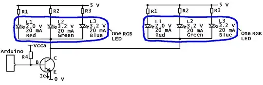

Small signal transistors, like BC 547B or 2N2222 can be used, but they can only drive one of the RGB LEDs as the emitter current, Ie, will be 60 mA in your circuit and their limit is typically 100 mA. I have shown a transistor driving two in the diagram below.

Alt text
I far as I can tell the RGB LEDs you are using are common cathode (where the "arrow" is pointing), hence the diagram above. The operating current is 20 mA and the forward voltage drops at this current are 2.0 V, 3.2 V and 3.2 V for red, green and blue, respectively.
Other values: R4 is in the kiloohm range, e.g. 3.3 kohm. One resistor is used for each internal LED as this makes for more uniform light and also accounts for the difference in forward voltage drop for red and blue/green. Vcca is the supply voltage to the CPU and can be different from the 5 V for LEDs.

For green and blue (R2 and R3): as the current is 20 mA through the diode the same current flows through the resistor. If the voltage drop over the driver (transistor) is assumed to be 0 V then the voltage drop over the resistor is 5 V - 3.2 V = 1.8 V. We now know the current and voltage for the resistor and can use Ohm's low to find the value of the resistor:
$$ U = R3 \cdot I \implies R3 = \frac{U}{I} = \frac{1.8\ V}{0.02\ A} = 90\ \Omega $$
For red (R1):
$$ R1 = \frac{U}{I} = \frac{5.0\ V - 2.0\ V}{0.02\ A} = \frac{3.0\ V}{0.02\ A} = 150\ \Omega $$
Standard values of resistors (E24, 5%) close to these two values happens to exist (91 ohm and 150 ohm).
