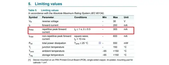

The maximum repetitive peak forward current for the BAT54J is specified as 300 mA in the data sheet. Take note: -
Simple math about the converter
To achieve 3.3 volts on the output of the buck converter requires a duty cycle of about 0.1375 assuming the converter operated in CCM. In other words: -
$$\text{Duty} = \dfrac{3.3\text{ volts}}{24\text{ volts}} = 0.1375$$
If the load was 500 mA, the power out would be 1.65 watts and that power has to be passed through the diode from the 24 volt rail in 13.75% of the time.
So, the average current from the 24 volt rail is 1.65 watts ÷ 24 volts = 69 mA but, given that this average is delivered in only 13.75% of the time, the peak current would be: -
$$\dfrac{69 \text{ mA}}{0.1375} = 502\text{ mA}$$
And this exceeds to peak stated in the data sheet.
Just rough and ready calculations of course.
