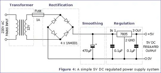

enter image description here (Source: Alan Marshall)
Here's a guide to each stage of the power supply circuit.
