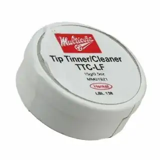

I've always used this stuff:
Multicore TTC-LF MM01921 Lead Free Tip Tinner / Cleaner
Datasheet
Photo of Multicore TTC-LF MM01921 Lead Free Tip Tinner / Cleaner
It doesn't work forever, and of course you must take good care of your tips. It can't repair all tips, but it does a pretty good job on ones which are slightly oxidised. I haven't found it gets stuck on the tip; just melt some solder on it after wiping the iron through the stuff to tin it again.
