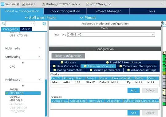

Is this a bug. First I created a new project and enabled FreeRTOS and then I set the Time Base Source to TIM3. Then I got hard fault.
  • STM32CubeMX IDE 1.4.0
  • Board Nucleo STM32 F401RE
I can upload the project as well as Test.zip. Available for 30 days. https://easyupload.io/bvhje2
Why?

euraad
  • 1,025
  • 30
  • You should probably start with a known good **static example** rather than use a code generator. It's doubtful that anyone is going to wade through all that machine generated code for you, and besides, stack exchange rules require that questions contain the critical information in the post itself - you've not yet reduced the problem to something that qualifies as a question here. – Chris Stratton Jul 27 '20 at 18:11
  • How have you configured stack and heap? – Justme Jul 27 '20 at 18:16
  • @Justme it's on default 128 Words. – euraad Jul 27 '20 at 18:18
  • @ChrisStratton Perhaps ST haven't tested version 1.4.0? I think I will downgrade to 1.3.0 – euraad Jul 27 '20 at 18:24
  • No it isn't, only your default task has 128 words default stack. The global stack and heap are elsewhere. – Justme Jul 27 '20 at 18:28
  • @Justme So you're telling me that...? I should increase the global stack and heap? – euraad Jul 27 '20 at 18:35
  • @Justme Did not have to do that in 1.3.0 – euraad Jul 27 '20 at 18:35
  • No I am not telling to increase them, just check if they have sane values and they are large enough. Also check the readmes what has changed if something affects your project. – Justme Jul 27 '20 at 18:40
  • @Justme Yes. They are the same. The thread has 128 Word Size and the Heap is 632 Bytes. – euraad Jul 27 '20 at 19:07
  • "Is this a bug" - yes. – Bruce Abbott Jul 27 '20 at 19:34
  • @BruceAbbott Ok. I think I will then downgrade to 1.3.0 – euraad Jul 27 '20 at 19:38
  • @BruceAbbott Yes. 1.3.0 works with FreeRTOS. Not 1.4.0 – euraad Jul 27 '20 at 20:45
You can change the line 73 in stm32f4xx_hal_msp.c from "HAL_NVIC_SetPriorityGrouping(NVIC_PRIORITYGROUP_0);" to HAL_NVIC_SetPriority(PendSV_IRQn, 15, 0).
It works for me.
