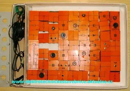

As I child, I had this electronic construction kit called Elektronik 1. It was manufactured in former Czechoslovakia, based on resistors, diodes, BJT transistors, capacitors, an LW+SW radio antenna and an earphone. It is quite simple, very good for children like 8 years old. It was originally powered from a 4.5 V battery (3 x 1.5V).
Elektronik 1
Now I try to recover the kit. I realized that diodes are all dead, some transistors are dead; all the other parts seems to be okay (including all those 30 years old capacitors). The original parts from eastern Europe aren't manufactured anymore, but it was easy to find some similar replacements. But the main question now is: Why those parts were damaged and how to protect them from another damage? When children play with this stuff, they can do many stupid circuits, because they are simply curious what will it do. So please tell me if you have got some tips what can be done there to protect those semiconductors from damages. Or at least a little bit.
