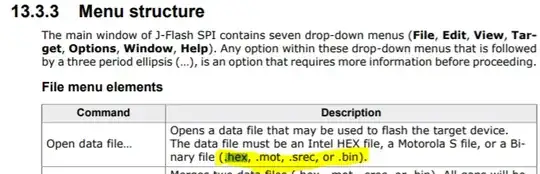

  1. In the J-Link Segger Debugger Manual, on page 279, chapter 13.3.3 Menu Structure, it is given as
it is mentioned as the software data file should be .hex, .mot,.srec or .bin format.
But my software datafile extension is .s28
So, will the debugger accept this file? Upon a simple google search, I found that the .s28 and .srec files are Motorola S-record is a file format, created by Motorola, that conveys binary information as hex values in ASCII text form. This file format may also be known as SRECORD, SREC, S19, S28, S37. It mentions that .srec and .s28 are the same?
So, I can load this .s28 file onto the Microcontroller with this debugger?

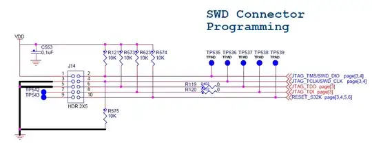

Schematic : Microcontroller - S32K118 64 Pin.
The reset signal on the base of the transistor shown below is on Always high state. So, it will not be a problem. For the JTAG Reset connection, I have taken the RESET signal from the C0103 Capacitor top end.

  • Have you connected 'RESET' or 'RESET_MC1' to the J-Link (along with all the other 'JTAG_xxx' lines? – brhans Jul 18 '20 at 15:48
  • Yes, I have connected the RESET line also to the J-LINK. –  Jul 19 '20 at 04:21

Question 2: J-Flash supports the following Motorola S file formats: .mot, .srec, .s, .s19, .s28, .s37 Therefor you should be able to flash your firmware generated by your toolchain.

The Pinout for the SWD/JTAG Connector should look like the following: enter image description here
Connection on the Controller should look like the following. I have highlighted the relevant Pins on the shematic for 32K118: enter image description here
In the example above only the SWD lines are connected to the 32K118. But you can of course also attach the other 2 lines for JTAG. The important thing which maybe are missing is the Reset line for the J-Link. Or is RESET_MC1 connected to the Debug Connector? Maybe you could post the shematic for the Debug Connector.

Regarding the .s28 format specifically:
Your binaries here are the good old Motorola S-record format, which is a file format expressing binaries using text representation - you can open it up in notepad.exe and read it. (Another popular and very similar one is Intel Hex.)
S-records consist of various entries. A line starting with S1, S2 or S3 means that it contains an address of 16, 24 or 32 bits respectively. A line starting with S7, S8 or S9 means that it contains the program's start address of either 16, 24 or 32 bits.
Apparently your binary is generated with 24 bit addresses, so your file will contain S2 and S8 lines. Hence the format .s28 - which can be regarded as a subset of .srec. Any tool claiming to support .srec will also support .s19, .s28 and .s37 since it is really all the same file format.
.mot probably refers to S-records too, though I can't say I've seen it used much.
And yes, all of these are supported just fine by Segger.
