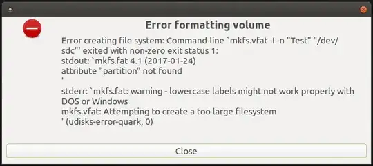

I tried the same thing under linux with the disks utility and got the following result: enter image description here

I watched the tutorial again and found that I have missed to increase the heap size. The problem is still the same. On linux the error message changed (see below), although I'm not sure if this is related to the heap size.

To my surprise, the error message is now different (for possible reasons, see update above):
I tried dmesg and the following is what I get for unplugging, replugging the device. The attempt to format the disk added no further entries to dmesg.

16 kilobytes? Is that the correct size of your device? I think mkfs is telling you that it can't create a filesystem that small.
Yes, that's correct. The tutorial uses 64, but my chip does not have that much SRAM, so I went with a smaller size.
I checked FAT size limits:
FAT32 minimum : 1 sector per cluster × 65,525 clusters = 33,548,800 bytes (32,762.5 KB)
This might be the cause of the problem, but if 33,548,800 bytes is the lower limit, why do the 64k work in the video? What am I missing here?

    16 kilobytes? Is that the correct size of your device? I think mkfs is telling you that it can't create a filesystem that small. – user253751 Jul 17 '20 at 18:32
  • @user253751 so is this a limitation of mkfs? I did some research (see edit), which suggests that this is indeed quite small. But then how come the 64k in the video work? Coincidence? – Magic Smoke Jul 17 '20 at 19:17
    You can actually test mkfs by trying to mkfs a file (which simulates a hard drive). You can look up how to make a certain sized file in Linux, then mkfs it. See if it works for 16k and 64k. – user253751 Jul 17 '20 at 19:23
