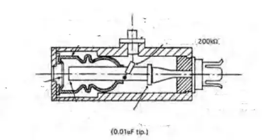

  1. In this picture there is another type of circuit (like the previous one but with a DC blocking capacitor). In the image of the real tube, it seems that the anodic resistor and the DC blocking capacitor are already inside the tube. Is it correct, or should the customer add them externally to the tube? enter image description here enter image description here

Circuit (2) appears designed for high-speed response. The internal bias resistor, and coaxial output (coupled with a series capacitor having no lead inductance) is designed to drive a 50-ohm load. Such an AC-coupled output is certainly meant for fast response time.
With this circuit, one might be cautioned to apply a high bias voltage +Va slowly, so that turn-on transient does not couple a huge spike to the external 50 ohm load RL. Such a transient could destroy a sensitive amplifier. Connecting a 50-ohm load after applying DC bias +Va could similarly discharge the internal 0.01uf capacitor as a huge transient into a 50 ohm RL. An internal large-value bleed resistor would be a good idea if +Va is large...this should be inside the shell, with the shell permanently grounded.
This is something you should look at the datasheet to determine. Do you have a link to where that picture came from? I am not entirely sure what it is showing.
