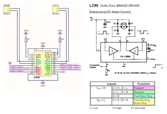

Appendix A - L298N Schematic and Operation
l298n 1
l298n 2
l298n 3

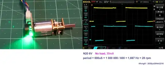

(a) I set 1kHz PWM signal to 100% duty, and also direct 6V PSU to check the motor speed. I found in both cases, the encoder output C1 is
600us, or 1000000/600 = 1666Hz, or 27rpm.
In other words, the motor driver does not seem to have any volt drop causing a reduction of motor speed.

  • I have been playing with toy motors TT130 and GB37. Your NA20 motor is too small for my big hands to handle. I remember I once carelessly fried two NA20 motors, by wrongly using too long screws, crashing the gear box, and too heavy loading sticking things. Perhaps I can search my junk box for any NA20 motors left over and tried it again. Ah, bed time. I call it a day. So see you on Sunday or Monday. Cheers. – tlfong01 Jul 17 '20 at 14:32

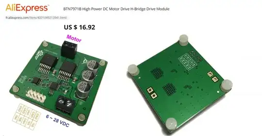

    **Do not use the L298,** like all Darlington devices it is truly horrible for low voltages with huge internal losses causing the calculations here to be quite innacurate and motor performance dissapointing. Use an FET bridge instead. – Chris Stratton Jul 19 '20 at 10:01
  • @Chris Stratton, Oh my goodness,your warning arrives just in time, because I was just about setting up the L298N to do the rotary encoder and PWM testing. On second thought, I better, as you advised, try a FET H-bridge first. Thank your very much. Cheers. – tlfong01 Jul 19 '20 at 12:37
