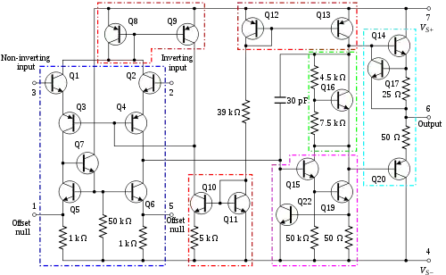

I've always been told that ideally, op-amps have infinite input impedance. So when I was looking at the LM741's transistor level schematic, I was confused when they used BJTs instead of MOSFETs.
opamp
Wouldn't using a BJT result in current flowing into the input pins?
