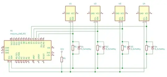

I've just run into this problem with multiple I2C devices with a fixed address. Our solution was to use I/O lines on the microcontroller to force the SDA lines high on the devices that we don't want to address, while the I/O line for the device we're targeting is set as input (high impedance). This means that only the targeted device matches it's I2C address and the others ignore any subsequent data.
Multiple I2C devices with same address
The resistors on the SDA line for the inactive devices end up acting as pull-ups for the bus, so the exact value will depend on how many devices you have and what pull-up you need for your bus. So if you choose 10K resistors, then 3 inactive devices gives a 3K3 pullup.
The schottky diodes ensure that the device can still pull the SDA line low enough when transmitting data back to the host.

  • I appreciate that you've followed up and posted this. This is a pretty ingenious solution, I'm certain it will be helpful to others. – Simon P Stevens Aug 22 '18 at 08:23
  • A nice niche that can be used on *some* applications. I like it a lot. – Harry Svensson Aug 22 '18 at 11:07
  • isnt this a workaround for wrong HW design ? What if we dont have extra IO pins to spare ? – a k May 21 '20 at 03:05
    This is the least expensive solution. Our product has two equal sensors and has no budget for any additional IC. Here we only add two diodes and one resistor. Thank you! – EmbeddedGuy Jun 27 '21 at 08:20
