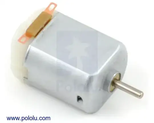

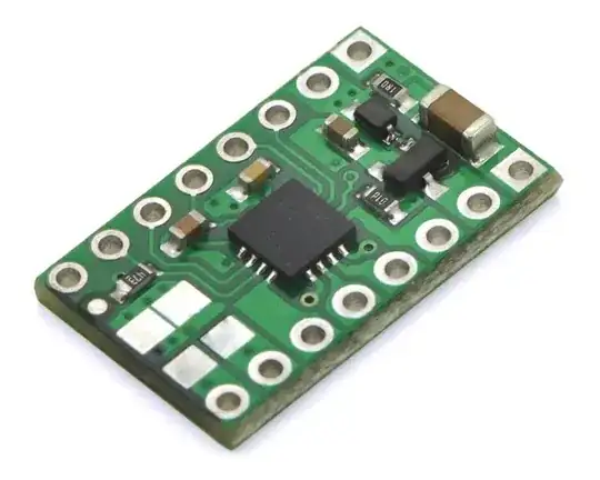

I'm using the kind of small brushed DC motor shown below. My MCU controls the motor using PWM via a DRV8833 motor driver, also shown below.
If I set the PWM frequency very low, e.g. 10 Hz, the motor clearly judders on and off. So for a smooth motion, it would seem obvious to set the frequency as high as possible.
However, above 100 Hz something odd starts to happen: the speed of rotation actually starts to drop off. I'm confused - I can vary the duty and frequency values independently and it was my understanding the duty value affects the speed while the frequency should just affect the "smoothness" (i.e. the judder) that I see at low frequencies.

When experimenting to find the optimum frequency, I kept the duty value at about 25%. I'm using a 3.3V ESP32 connected via two PWM pins to the A_IN1 and A_IN2 pins of the DRV8833 chip (i.e. pins 15 and 16). I'm using a library where the PWM duty value is a 10-bit value that can vary between 0 and 1023 - I keep it fixed at 255 for A_IN1 and 0 for A_IN2.

    Please edit your question to add (a) the mark/space ratios you are using and therefore (b) the minimum mark pulse periods. That's when you see these problems and the min you can deliver. The DRV8833 has an output enable/disable time so very narrow pulses will not make it to the motor. Also edit in if your PWM drives the motor (a) HIGH and LOW or (b) HIGH and HI-Z. It should be (b). For frequency, please look at https://electronics.stackexchange.com/questions/242293/is-there-an-ideal-pwm-frequency-for-dc-brush-motors/243336#243336 – TonyM Jul 08 '20 at 15:04
  • Apologies for the late reply (I work at a startup and the last while was kind of busy). I've added two additional paragraphs, with more details, to my question. I'm an electronics hobbyist so some of your terms are new to me. As I understand, mark/space ratio means the same as duty cycle. But I'm not sure what you mean by the "the minimum mark pulse periods?" – George Hawkins Jul 19 '20 at 14:52
  • Similarly, while I understand HI-Z means high impedance, I'm not sure what it means in terms of the library I use to control the A_IN1 and A_IN2 pins of the DRV8833. With this library, I can just set a frequency value and a duty value - the frequency can be between 0 Hz and ~80 KHz and the duty value can be between 0 and 1023. – George Hawkins Jul 19 '20 at 14:53
