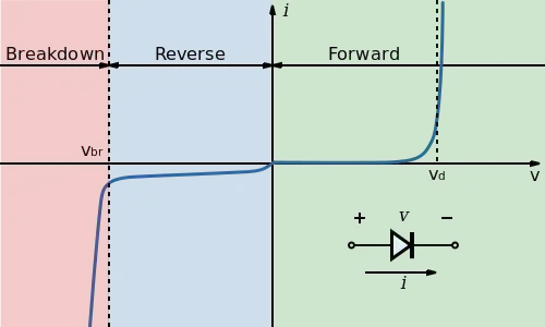

  • All diodes in your schematic are drawn backwards. The triangle of a diode points to the cathode (-).
