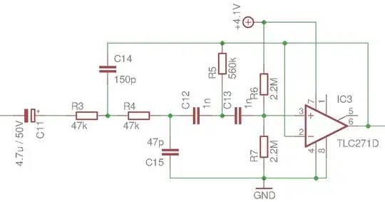

Here is my input stage:
Single Wire Telephone input amplifier
It is essentially a high input impedance voltage follower with an extra passband active filter. The telephones are powered from a single lithium ion cell, so in normal circumstances we expect not much more than 4.2 Vpp on the line...

Next, you don't need C11 if that's all you have. If you have an output amplifier you need to reveal that because the input amplifier will survive without any further TVS devices.
  • Thanks for pointing out that C11 is bogus! It is needed in the original design I quoted - presumably for removing DC bias when the circuit is *transmitting*. But the original circuit uses a clever arrangement to switch a single op-amp between receiving and transmitting, whereas I have separate Rx and Tx amplifiers and a Rx/Tx relay. So I indeed don't need it in my *input* amplifier! – Mateusz Jun 30 '20 at 17:30
