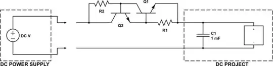

Insert an Active Circuit
Assuming you can tolerate the \$\approx 2\:\text{V}\$ loss just mentioned, you could use an in-line (series) active circuit to limit the inrush current. Because it is active and uses BJTs, though, you must accept the loss of \$\ge 1.5\:\text{V}\$ for the circuit. If that's too much to accept, then it's probably better you don't consider it.
But assuming you can accept such a voltage loss, it does allow you to limit the inrush current to about twice the maximum expected load current.
Let's start out with the schematic:
simulate this circuit
The basic idea here is that at the beginning of the charge-up cycle \$Q_1\$'s \$V_\text{BE}\$ will be about as large as possible -- around \$1\:\text{V}\$ -- and that near the end of the start-up cycle \$Q_1\$'s \$V_\text{BE}\$ will be about as small as possible -- around \$500\:\text{mV}\$.
You want to set \$R_1=\frac{500\:\text{mV}}{I_\text{LOAD}}\$, where \$I_\text{LOAD}\$ is the maximum expected value during normal operation, because once the start-up cycle is finished \$R_1\$ will be supplying the load current and dropping \$500\:\text{mV}\$.
The peak current will be in the vicinity of \$\frac{1\:\text{V}}{R_1}+\frac{V_\text{CC}-1.6\:\text{V}}{R_2}\$, but if you try and reduce the peak current by making \$R_2\$ large this will also mean a larger voltage drop across the entire circuit after the start-up cycle. So you should want to set \$R_2\$ fairly low. A good balance is to have \$R_2\$ supply a peak added current that is a little less than the expected load current.
So, taking the above example using only a resistor, where I suggested a nominal load of \$700\:\text{mA}\$ and \$V_\text{CC}=24\:\text{V}\$, you'd set \$R_1=\frac{500\:\text{mV}}{700\:\text{mA}}\approx 680\:\text{m}\Omega\$ and \$R_2=\frac{V_\text{CC}-1.6\:\text{V}}{90\,\%\:\cdot\: 700\:\text{mA}}\approx 39\:\Omega\$. With this arrangement, the circuit will limit the current to a maximum of about \$2\:\text{A}\$ and will drop about \$1.9\:\text{V}\$ during normal operation.
This circuit still dissipates power, of course. It's just that the power is now distributed across the two BJTs and \$R_1\$. It may be helpful, allowing smaller parts in some circumstances, but in other circumstances you might prefer just having a single larger resistor to take care of the dissipation load. Regardless, whether you use a single resistor or a more complex circuit, there's no escaping the dissipation.
