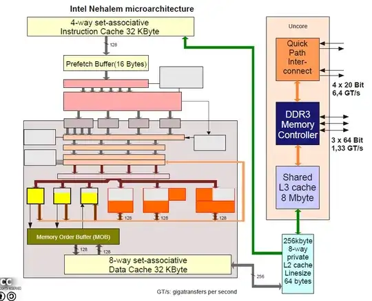

I don't fully understand this picture:
If the data and instruction caches are separated, doesn't that mean that this CPU is not von Neumann model but Harvard model?
And what does it mean that one cache is 2-way and one cache is 4-way?
Niklas Rosencrantz
  • 1,694
  • 62
No, having separate caches does not turn a von Neumann machine into a Harvard machine; both caches still represent the same external memory. But separating the caches for instructions and data improves performance by preventing the two streams from interfering with each other.
The set-associativity, or "way"-ness of a cache is simply an indicator of performance (hit rate). It refers to the number of aliases for a particular cache slot that can be held in the cache before one of them needs to be replaced. In general, a cache with higher associativity will have better performance on most typical kinds of code, at the expense of requiring more complex control logic.
Dave Tweed
  • 168,369
  • 228
  • 393
    The associativity isn't an indicator of performance. Instead a higher set-associativity gives it better performance. – Brian Carlton Dec 07 '12 at 00:35
  • @Dave, "Alias" refers to? – Pacerier Sep 19 '17 at 06:59
  • @Pacerier: Some subset of the memory address bits (usually LSBs) is used to select, or "index" a particular slot in the cache. The remaining address bits (usually MSBs, and called the "tag") can take on any value, and the set of memory locations that they represent are called "aliases" for that cache slot. – Dave Tweed Sep 19 '17 at 11:05
