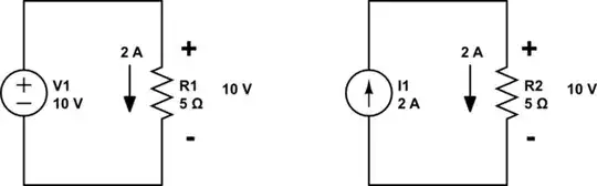

A few days ago a similar question was asked for the simple circuit below consisting of three elements in series (voltage source, resistor and current source). Despite professional explanations, the OP could not understand why in the lower diagram the voltage drop across the resistor was added to the source voltage and not subtracted.
Original question
I was watching the discussion with interest because I have encountered this circuit in many interesting electronic circuits. I made a brief comment on the nature of voltage and current sources... and at this point the OP impulsively asked me to explain why VR1 was added to V1 to obtain Vo. How can you not respond to such a touching request? I started thinking about what the OP's problem with understanding was and how to solve it.
Unexpectedly for me, however, the OP removed his/her question. But I still decided to finish my answer and publish it under a more precise question...

Such circuits, in which voltage drops are added/subtracted according to KVL, can be visualized in an attractive manner by voltage bars (in red) with a proportional height. If we ground the circuit, we can observe the four combinations below between the source directions. Let's consider them.
1. Positive voltage, positive current. This is the usual case when a voltage source with positive voltage is discharged by a load. The interesting thing here is that the role of the load is performed by a current source (more precisely, sink); so the voltage source is discharged with constant current.
Fig. 1. Current source (sink) discharging a positive voltage source
As in the classic circuit with a passive load (e.g., a resistor), the voltage drop VR1 across the resistor R1 is subtracted from the voltage V1 and the resulting voltage Vo across the current source is zero (V1 -VR1 = V1 - I.R1 = 10 - 10 = 0 V). It is interesting that VR1 is constant… and if V1 varies, VR1 will not vary… so Vo will follow V1 variations. You can think of R1 as another "battery" with voltage VR1 connected in series with the main battery V1.
This effect can be observed in a common-emitter amplifier stage where if the supply voltage varies, the collector voltage follows it. Also, it is used in some op-amps to "shift down" the voltage variations.
At the OP's conditions (V1 = 10 V, R1 = 5 ohm and I1 = 2 A), the voltage drop VR1 is equal to the voltage V1; so the output voltage Vo across the current source is zero (like a virtual ground). I have considered this situation in more detail in Fig. 6 below. It would be interesting to increase the current and to see what Vo will be.
2. Positive voltage, negative current. Let's reverse the current source (the OP's problem). Now the voltage source becomes a "load" which is charged by the current source.
Fig. 2. Current source charging a positive voltage source
The voltage drop VR1 across the resistor R1 is added to the voltage V1 and the resulting voltage Vo across the current source is two times higher (V1 + VR1 = V1 + I.R1 = 10 + 10 = 20 V). Interesting… is it a voltage doubler?
Since VR1 is constant when V1 varies, Vo will follow V1 variations. Again, you can think of R1 as a floating "battery" with voltage VR1 connected in series and in the same direction with the main battery V1. So there is nothing special in this case either. See also Fig. 5 where a conceptual internal circuit of the current source is shown.
The most typical application is charging a rechargeable battery with internal resistance R1. Also, the weird negative impedance converter (INIC) resembles this circuit.

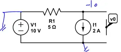

It's actually very simple. I1 is generating a current that flows through R1 no matter what else is in the series circuit - and the voltage across it has the same polarity that it would have if a voltage produced that current.
Therefore in the upper circuit the resistor must have positive on the left because the current is going through it from left to right, and in the lower circuit it must have positive on the right because the current is going from right to left.
In the case of voltage applied across a resistor, the resistor takes on the polarity applied and draws a current according to Ohm's law (I = V/R). In the case of current forced through a resistor it behaves exactly the same, with V = I*R.

not only i want to answer to this question completely but i want to make an application with this simple circuit so we would know what was the purpose of creating these simple circuits.
let's say in our circuit we have 2 constant elements which are the current source and the resistor and we have a battery which we could remove it and make the voltage source as ground. so everything i have is this circuit and i want to write mu name and others names with this single circuit at the vo or output.
analysis of the circuit : part 1:
in the above we know how this circuit works. in summary because the current is fixed the vo would be equal to 0 so that we have a current = 2A passing through the resistor and going to ground.(v0=0). now i see the question arises here that people are asking what would happen now to the current source when both sides are 0 volt. enter image description here
if you pay attention the current source is equal to 2A and more importantly its an independent current source. by definition an independent current source with the value of A ampere has always A ampere current regardless of what the load is whether the load is open circuit or short circuit. that's why we say in real world there is nothing like an independent current source, because we can't make such a thing and that's why the above circuitry created by @Circuitfantasist (in the above response in part 5) is wrong even though its just a simple simulation. with no circuit you could make an independent current source. but let's say why use it? well now the vo = 0 even if remove the current source which currently does not have any effect but i don't want to do that. what we want to do here is to remove the battery or in other words connect that node to the ground like this: enter image description here
what i mean is that instead of a constant voltage of 10v , you imagine that you have a voltage source which oscillates between 10 and 0. now in this case we would have:
v0 = 5(-2) = -10v
so as you see we only have two states for the output voltage of vo. its whether 0 when we have 10v at input or its -10v when we have 0 at input.
now lets create our application:
from now on instead of -10,0 i want to say 0 and 1. so whenever we have -10 let it be 0 and when we have 0 volt at the output think of it as 1.

second 1: put the voltage 0 as the input ----> we have 0 at output
second 2: input = 0 ---> output=-10v
second 3: input = 0 ----> output = -10v
second 4: input = 0 ----> output = -10v
second 5: input = 10 ----> output = 0v
second 6: input = 10 ------> output = 0v
second 7: input = 0 -----> output = -10v
second 8: input = 0 -----> output = -10v
so its like we keep the input at 0 for four seconds , then for two seconds we put 10v as the input and again for 2 seconds we make it zero again and we write the vo at each seconds.
considering the face that we said -10 = 0and 0 = 1 so we would have this values for the above:
-10 -10 -10 -10 0 0 -10 -10
0 0 0 0 1 1 0 0
00001100 in binary is equal to 12 in decimal and we just said that we encode numbers as letter based on this(just convention for all parts):
0 1 2 3 4 5 6 7 8 9 10 11 12 13 14 15 16 17 18 19 20 21 22 23 24 25
a b c d e f g h i j k l m n o p q r s t u v w x y z
and so 12 would be equal to m .
then i wait for 5 seconds and repeat everything some how that i could make these two numbers:
00000110 -->6 ----> g
00000111 --->7----> h
and therefore the person that is writing values of vo at the input miles away from the input!!! that i am changing it could know that its "mgh" written at the output.
