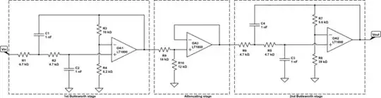

So here's a shot at it. In contrast to the discussion I had with Andy (see the discussion below his answer here), I'll select the higher-Q stage (and therefore also higher gain) to be the 1st stage. The reason for this is that you usually want the highest gain as the 1st stage for noise reasons. However, keep in mind that I've no idea what's driving this system and you may want either still more more gain, or less, in the first stage. So you may actually want a "pre-amplifier." But since we know nothing, really, let me just choose a path and follow it. Meanwhile, it's important that you keep in mind that this is just a choice and not necessarily the better choice for any given circumstance.
With that choice for the 1st stage, I'll follow it by an attenuating stage which only has the single purpose of reducing the signal sufficiently so that the final 2nd Butterworth stage can pick up from there and complete the picture.
simulate this circuit
The result looks like this:
Which is as would be expected.
As I said before, it's not all that complicated.
