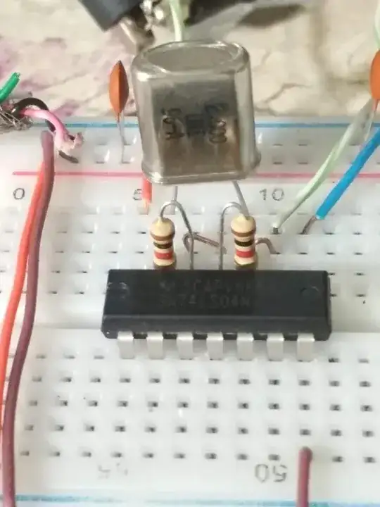

Here is the proof. My test circuit: breadboard experiment

    Building that circuit on a prototyping plug-board is asking for trouble - the parasitics are usually too high for such circuits. Also the more common arrangement uses a Pierce oscillator with a single amplifier. Your circuit operates the crystal at series resonance. – Kevin White Jun 21 '20 at 02:09

    Where did you copy this circuit? Why there is no AC coupling cap between inverters? Why build a parallel resonant oscillator with LS04, while a series resonant oscillator with HCU04 is more common and people have less issues with it? – Justme Jun 21 '20 at 07:58

    The circuit that is being used does not require the phase inversion as it has inverting amplifiers in cascade. It requires a crystal designed for series resonance. The more common oscillator uses an inverting amplifier and then relies upon the crystal and capacitors to provide the other 180 deg of phase shift. The circuit shown also has the disadvantage that parasitic capacitances can cause oscillation even without a crystal at all - this is particularly relevant since it has been constructed on a prototype board with very high parasitics. – Kevin White Jun 21 '20 at 02:07
  • A breadboard has large parasitic capacitance, usually enough for a crystal. – Turbo J Jun 21 '20 at 05:02
    @TurboJ - A crystal in series resonance does not require one, it could stop it functioning or alter the frequency. The amplifier already provides al the phase shift required for oscillation - in fact it will tend to oscillate without a crystal. – Kevin White Jun 21 '20 at 19:21
