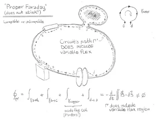

  4. The Romer-Lewin ring, or: the unlumpable circuit
    Where we see that when the circuit path encloses a variable magnetic flux KVL is no longer salvageable, and voltage in your circuit becomes path dependent (which means: it is no longer possible to express it as potential difference)

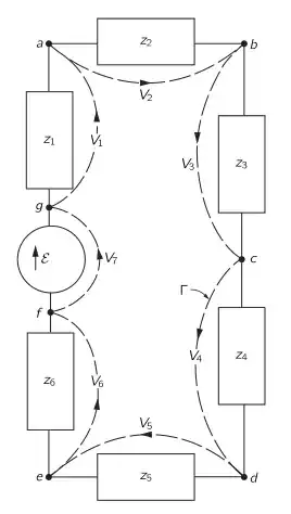

Suppose we have a circuit consisting of a generator and several impedances connected together, as shown in Fig. 22–9. According to our approximations there is no magnetic field in the region outside the individual circuit elements.
Therefore the line integral of E around any curve which does not pass through any of the elements is zero. Consider then the curve Γ shown by the broken line which goes all the way around the circuit in Fig. 22–9. The line integral of E around this curve is made up of several pieces. Each piece is the line integral from one terminal of a circuit element to the other. This line integral we have called the voltage drop across the circuit element. The complete line integral is then just the sum of the voltage drops across all of the elements in the circuit:
Since the line integral is zero, we have that the sum of the potential differences around a complete loop of a circuit is equal to zero:
This result follows from one of Maxwell’s equations—that in a region where there are no magnetic fields the line integral of E around any complete loop is zero.
So, KVL is just a particular special case of Faraday's law, when the electric field behaves in that magical way that will refill your gas tank when you go from the top of the mountain back to the parking lot. If your circuit path encloses a varying magnetic field then you are out of luck: the voltages in your circuit will not have unique values for the same endpoints but will also depend on the particular path along which you compute the line integral. But notice that Feynman says:

4 - The Romer-Lewin ring
In the Romer-Lewin ring two (lumped) resistors are placed inside a coil enclosing a variable flux region so that the circuit's path encloses a dB/dt region. Feynman is adamant: you cannot use lumped circuit theory. Lewin is also adamant: you cannot use Kirchhoff's law (it's for the birds!), so we need to go back to the more general relation: Faraday's Law.
If you accept that the variable B field will generate a rotational E field, things can be explained by looking at how charges in the circuit react to the induced field, change their configuration and produce a different resulting electric field inside and nearby the ring.
If you were to magically make the ring made of copper conductor and two resistors appear inside this circulating field, the charges inside and on the surface of its parts would almost instantaneously redistribute themselves in such a way as to obey Ohm's law.
We can get a glimpse of what drives the charge redistribution by considering the continuity equation. Charge displacement - gradients in charge density \$\rho\$ - happens on the surface also in the longitudinal direction, anywhere there be gradients in the values of conductivity and permeability. If we assume \$\frac{\partial \rho}{\partial t}=0\$, then the continuity equation becomes div j = 0 and by adding compliance to Ohm's law we get

  • @SlavenTojic in the Lewin ring with resistors the charge that has been displaced by the induced rotational field will accumulate at the resistor's boundaries, giving rise to the strong electric field inside them and, by superposition (between the induced and coloumbian fields generated by interface and surface charges), to the resulting small E = j / sigma field directed along the conductor in the verse of the current. In an uniform resistive ring you have to imagine the resistors as distributed along the length of the ring so that the only resultant field will be E = j / sigma. – Sredni Vashtar Nov 11 '20 at 13:34
  • Also, the L di/dt explanation does not work. Firstly, in the Lewin experiment the self inductance L is negligible, and not even M di/dt can save you because well, I can do the same experiment with a falling magnet. Unfortunately I've hit the 30k character limit and cannot add the rest of my answer. I might write a second answer to another of the question pertaining the Lewin paradox on this site, I'll see if I find the time (the part on partial inductance is pretty interesting...) – Sredni Vashtar Nov 11 '20 at 13:36
When computing a current change due to a magnetic flux change, what can be more "ideal" then a zero-resistance circular loop in a uniform magnetic field with the field's strength linearly increasing/decreasing in time? With the help of the Maxwell-Faraday equation in integral formulation (Faraday's law) we immediately arrive at the answer.
But it is often overlooked that the path to solution via application of Kirchhoff's voltage law is not any harder. First, we have an EMF generated by an external magnetic field (a given value EMF_ext). Then, in a zero-resistance wire any non-zero voltage drop is prohibited by Ohm's law, so an EMF from a magnetic field generated by a current in the loop (an EMF_current value) has to fully compensate E_ext. EMF_current + EMF_ext = 0, and further calculations are trivial. One thing to notice: the exact formulation of Kirchhoff's voltage law states
Kirchhoff’s second law is as follows: the sum of electromotive forces in a loop equals the sum of potential drops in the loop.
What leads to mutual misunderstanding (as in our discussion) is an omission of emf contribution, or, more precisely, early substitution of some invented voltage drops for EMF contribution in someone's circuit analysis. The emf part of the exact Kirchhoff's formulation is missing even in a Wikipedia article on Kirchhoff's circuit laws.
