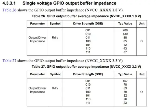

I looked through the datasheet and did not find an absolute max GPIO output current. For what it's worth tables 26/27 mentions GPIO output impedance.

  • That sounds a lot more reasonable. I suppose I'd want to set the drive strength to its maximum for the optocoupler pins and then use a current limiting resistors as `Rled = ((3.3V - Vf) / If) - Rdrv`? – towe Jun 19 '20 at 06:51
  • That seems like a sound idea. For 5mA the ~23Ω of output resistance shouldn't muck with the resistor sizing too much (would give 4.8mA instead of 5mA assuming 1.15V forward voltage drop, 3.3V GPIO output, and 23Ω output impedance). Taking into account the output resistance results in closer actual output to the target 5mA. – Yet Another Michael Jun 19 '20 at 07:35

The easiest way is to use GPIO output buffer avg impedance from the datasheet to calculate maximum possible current the pin could drive (See Warning below).
See the table below, let's assume you're working on 3.3v with max drive strength (111). So you have maximum current = 3.3v/23 Ohm = 143.5mA. But this is just a coarse value.
