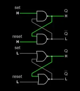

The NAND-based flop will set and reset based on the falling edge of an input. The inputs are considered active-low.
The NOR-based flop will set and reset on the rising edge of the input. The inputs are considered active-high.
Try them here: NAND, NOR SR latch sim in Falstad
