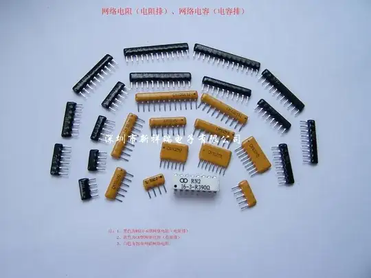

A common way of reducing part count, not resistor count, for such designs is to use a common bus resistor network or array:
Common Bus Resistor Array (from here)
These are available as through-hole SIP/DIP as well as SMD, in a variety of resistor counts, depending on your needs. The bus pin is connected to ground, and the other pins are connected to the respective MCU inputs as in your schematic. SIP resistor arrays (from here)
SMD resistor arrays (from here)
