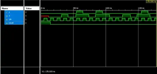

Simulation Output :-
The issue is that, I'm getting the number of '1011' detected to be correct (i.e. 3 according to the testbench). But the timing where the output is going high is wrong. The output 'z' is going high when '101' is being detected, when it's expected to go high when '1011' occurs. What's the possible modification that I'd have to do, so as to eliminate this error ?

The error is caused by mixing the combinational State assignment block with the sequential output block. The combinational state assignment block and the sequential output block have different sensitivity lists.
Following these guidelines helped me design glitch-gree FSMs.
  1. Sequential blocks use nonblocking assignments.
  2. Combinational blocks use blocking assignments.
  3. It's better to use registered outputs.
  4. Use combinational logic for the state assignment block
Link to the design on EDA Playground

Waveform: https://www.edaplayground.com/w/x/3Pj waveform

  • Hi Shashank, can you please explain why your output goes high in the same cycle as the last bit in 1011 goes high? Shouldn't output go high only in the next cycle because you have used output as a flop by means of the <= and the posedge block? – penguin99 Dec 09 '21 at 17:13
  • @penguin99 `z <= (PS == S3) && x;` Because x is a direct input to the output, so it gets updated in the same cycle – Shashank V M Aug 06 '22 at 15:33

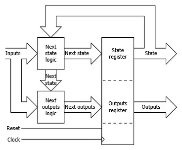

Great answers by Shashank, but I would like to highlight a subtle issue with registered outputs, i.e. a delay of one clock cycle between the change of state and the change of outputs. This is easy to overcome by slightly rearranging the logic. This rearranged topology keeps the outputs synchronised to both the clock and the change of state. It works by calculating the next outputs from the next state (which is subtly different from calculating the present outputs from the present state). Then the next state and the next outputs are clocked through together at the next positive clock edge.
Schematic of fully synchronous Mealy machine
Figure 1 – Schematic of fully synchronous Mealy machine.
Fully Synchronous Mealy Machine of Sequence Detector in SystemVerilog

More Mealy Information
Compare the fully synchronous Mealy machine of Figure 1 with the following Mealy machines.
Schematic of Mealy machine
Figure 3 – Schematic of Mealy machine.
Schematic of Mealy machine with registered outputs
Figure 4 – Schematic of Mealy machine with registered outputs.
The registered outputs create a kind of pipeline architecture so the outputs are 1 clock cycle behind the state.
The rearranged topology of Figure 1 keeps the outputs synchronised to the state by lumping the combinational logic together which calculates the next_outputs from the next_state. To reiterate this subtle but important point: this is different from calculating the present outputs from the present state. A potential caveat of lumping the combinational logic together is that it removes the 'pipeline' so you might need a lower clock frequency to allow the combinational logic to settle.
As an example, full synchronisation is important for an IoT Factory 4.0 environment where a snapshot (state and outputs) of all the machines in a factory needs to be taken periodically.
You can redraw it like this fully synchronous generic state machine. Whether its Moore or Mealy fades into esoteric academicism. Just write the combinational logic for your requirements.
Schematic of fully synchronous generic state machine
Figure 5 – Schematic of fully synchronous generic state machine.
