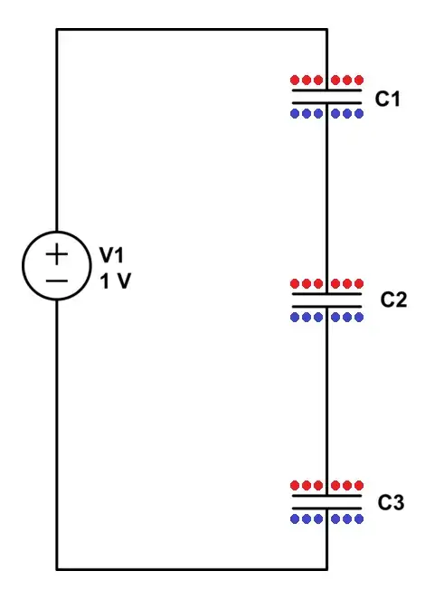

If capacitors are connected in series with a vltg source, then how would each plates get the polarity?
When a voltage is applied to (say) three capacitors in series, the charge carriers (electrons) distribute themselves like this: -
The wires that feed C2 have no net charge but the electrons still redistribute themselves due to the influence of C1 and C3. Given that each capacitor in series is subject to the same movement of charge carriers (electrons), the voltages that arise is dependent on the capacitance as per the formula: -
$$Q = CV$$
Would current exist between each capacitors?
Current will flow as per the standard equation for a capacitor: -
$$ i = C\dfrac{dv}{dt}$$
And, if the voltage was applied instantaneously, dv/dt would be infinite and current would be infinite (and infinitely short) and the capacitors would charge up instantaneously. Nevertheless, the final voltages across each is dependent on the common charge and CV.
