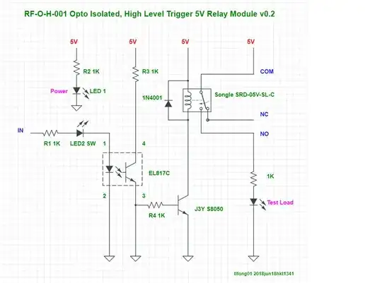

Part A - Simple High and Low level trigger relay modules without optical isolation
To explain the idea of Low and High trigger relays, let us start with the no optical method and look the the respective schematics below.
low high trig relays
high trig relays

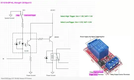

The over simplified schematics give a rough idea of the operations of High and Low trigger circuit. Real circuits must have a "flyback diode" to absorb the energy of flyback current when switching off energizing current. An "optical isolator" is usually used to prevent/reduce EMI (ElectroMagnetic Interference) noise going back to the signal source (Raspberry Rpi). Noise usually also goes through the ground wires. That is why the "JD-Vcc jumper" coming in, to do "Total Optical Isolation" (More about his later).
I am only making an educated guess that the OP's relay is low level triggered. There is a small chance that his module is actually High level triggered, as shown below. In this circuit, High signal activates/turns on relay switch.
high trig opto

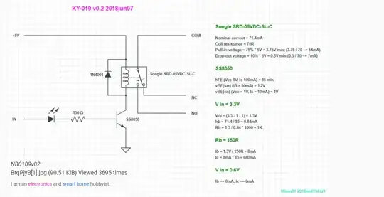

We will use the following High trig relay to explain why that there is no such cannot-turn-off-relay problem.
ky019 -1
ky019- 2
ky019 -3
The following picture shows why for Arduino High (> 4.2V) trigger relay, even Rpi's High (> 2.4V) is still enough to trigger the relay.
high trig relay operation

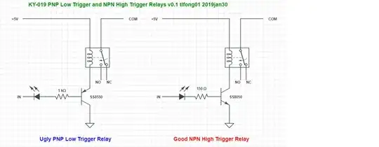

Appendix F - Why Low Trig Relays (JD-Vcc or otherwise) often have Rpi High not High enough problem?
Reference (10) Transistor Load Line Analysis - TutorialsPoint
It hard to explain. You need to contrast the High trig NPN and Low trig PNP circuits and V-I characteristics (narrow cutoff, wide active/saturation band) to appreciate that it is hard to bias the Low trig relay such that both Arduino High of 4.2V and Rpi 2.4 ~ 3.2V can cut off the relay.
pnp vs npn cct

  • @Circuit fantasist, sorry to replay late. I guess you mean either the schematic (a) above title of Part C, or the schematic in Part D. It is true that the emitter is directly shorted to ground, but the resistor connecting Vcc and Collector should limit the current through the resistor. Also I guess the light from opto LED would generate the base current (which is small) to ground, so should be OK. BTW, I just copied the schematic from some user manual. Perhaps I should double check later. Thank you for pointing out the problem. Cheers. – tlfong01 Nov 05 '20 at 09:21
    I have similar module but with "total-isolation" where is the ground pin correspoding to JD-VCC? If you don't connect GND of control and load circuits then you need to connect GND of power supply for load circuit somewhere - but there is no pin for it? – Petr May 12 '22 at 08:35
  • @Petr: Can you give me a link or a photo of your "similar" module? – tlfong01 May 12 '22 at 09:55
    Yes here, it's actually exactly same as picture in your answer - https://dratek.cz/photos/produkty_gal/f/4/4976.jpg basically I am looking for Part E of this answer where there is total isolation between controlling circuit and load (which has dedicated power supply). My assumptions is that if I connect JD-VCC to this dedicated power supply, the relays themselves would be powered from it, causing no interferences with the controlling circuit. But if JD-VCC is +5V input - where is its dedicated GND? – Petr May 12 '22 at 10:39
    I am controlling 4 electric pumps using ESP-01 wi-fi microcontroller which is so extremely EMF / EMI / voltage drop intolerant that every time I switch any of the relays it resets. That's why I want to take advantage of optocouplers in the module so that the circuit powering the ESP controllers doesn't physically touch the circuit powering the motors. – Petr May 12 '22 at 10:41
  • OK. So your relay is ***not SIMILAR but EXACTLY the same***as the picture in my answer. Let me see how to show you the wiring. May take one or two days. Stay tuned. – tlfong01 May 12 '22 at 11:46
  • My answer about RPiGnd is in Appendix G. I know it is not very clear. Perhaps you can add more explanation there. – tlfong01 May 12 '22 at 12:31
