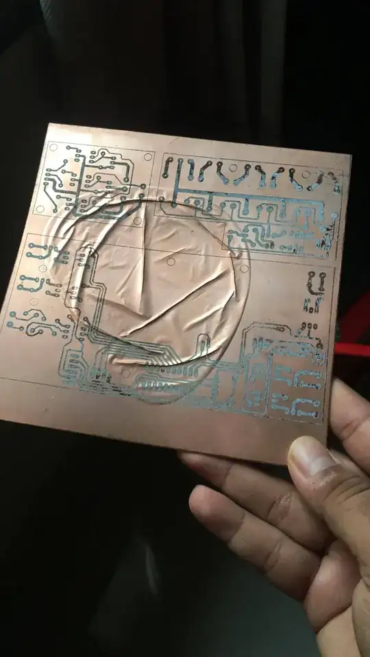

And this is how I implemented it physically. Excuse my unaesthetic solder work because I had to put everything on the same board, I did some scraping to create new pads: enter image description here
It works just fine, the temperatures of the components are fine, nothing is too hot to touch for less than 10 seconds. The LM317 is well heatsinked by the aluminum PCB, and its maximum power dissipation in this circuit is 1W.
