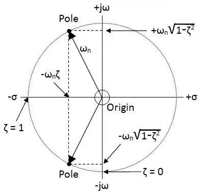

And, if you were to look downwards from above you would see the pole zero diagram (aka the s-plane diagram): -
At the pole points above, the transfer function response will be "infinity" but these poles are not aligned to the \$j\omega\$ axis and, in effect, they are in a realm that has no physical existence.
Hopefully this will help you realize that "s-plane real numbers" lie on a different axis to the \$j\omega\$ axis. It's sometimes called the \$\sigma\$ (sigma) axis and represents how much damping the system has. Low damping means that poles get close to the \$j\omega\$ axis. High damping means that poles move further from the \$j\omega\$ axis.

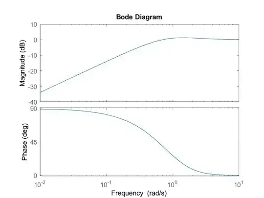

Particularly you need to remember that a Bode plot is given in two parts: the magnitude and the phase of your transfer function. The graph you provided is only the magnitude plot of H(s), which is an incomplete picture of the Bode plot for H(jw). The following are the magnitude and phase Bode plots of H(s): Bode Plot of H(s)

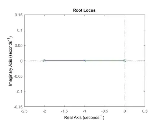

Another way of analyzing your transfer function and see when it becomes zero, or infinity is to perform the Root Locus. Root Locus Plot for H(s)
Your transfer function will be zero at the zeros and infinity at the poles. In a root locus plot, we see that the function will approach the zeros from its poles, that is, H(s) will be stable if for every pole, there is a correspondent zero, amoung other rules.
