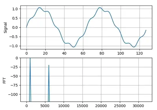

Let's make a 1kHz signal, add some 6th harmonic, and sample it at 64ksps: the output spectrum contains 1k and 6k (this time the X axis is correct).
...but if the output after the distortion is added is sampled at 8ksps, because the DAC works at 8ksps, then the distortion aliases back at 2kHz into the output spectrum.
The actual DAC output signal would look like this, with zero order hold applied. That simply tiles the spectrum like puzzle pieces, and on each of these copies of the spectrum, the 6th harmonic is at the same frequency as the 2nd would be. A filter will get rid of the frequencies above Fs/2, but the part that aliased into the Niquist band is impossible to get rid of without also removing the signal.
