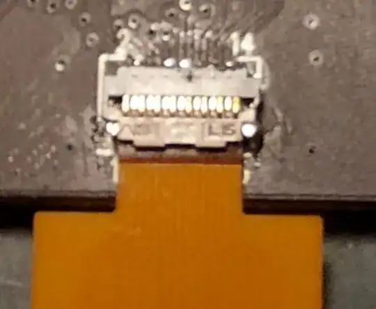

We settled for a ffc component in the end, and we think that we got this right this time.
ffc connector - SMT - but hand soldered in this image The issue with connecting ribbons to rigid boards is a hard one IMHO.
So I would say that the answer is to use an ffc and then glue the ribbon. The solder work was too fine - and that had not been identified in the original question.
