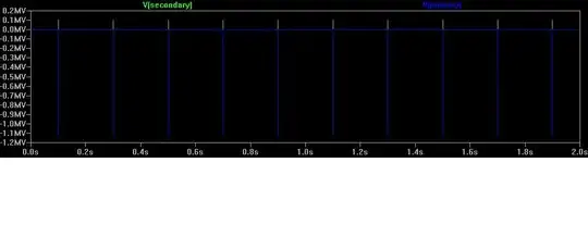

Secondly, at the time I didn't know about "snubber networks" so I did not include one. I've just now come to understand a little about "inductive kick" and realize that though it was probably too transient for my meter to register, it is possible I was generating voltages on the secondary upwards to the kilo-volt range and reverse voltages on the primary in the mega-volt range. I say this because I simulated this with Lt-spice and though I know I didn't account for capacitive coupling between windings, core losses, wire resistance, etc. the simulation shows some pretty nasty voltages. I'm sure there must have been some bad arcing going on in the switch which dissipated the bulk of the energy; however, could it have damaged the multimeter, and if I had hooked it to an oscilloscope capable of detecting such a signal, would that have damaged it?
Here is the Spice schematic:
And the output:

    Those megavolt values you are getting are probably a consequence of the ideal model (hint: V = L di/dt in an inductor) of the transformer. In a real transformer (with losses) those spikes will be much less noticeable due to transformer losses. – Renan Dec 01 '12 at 22:15
    Renan is right - you would need to include some series and resistance parallel capacitance in your inductor model (right click, try a few pF to start with). In reality the voltage will be high, but unlikely to be anywhere near 1MV. Also, limit the switch on to off time to a reasonable value like > 1us or so. – Oli Glaser Dec 02 '12 at 02:17
